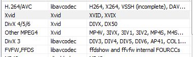

The Packed Bitstream AVI fix ONLY works if you use the latest XVID codec and not ffdshow's xvid decoder. It works then.
From the other thread:
Always use packed bitstream with avi and use xvid to decode instead of ffdshow. Unticking decoding xvid in ffdshow (both vfw and non-vfw) and installing the latest xvid makes the problem go away. -
I had to uninstall xvid for ffdshow to be used again. Anyway, tried all 3 ffdshow settings :-
1. disabled = virtualdub had no codec to decode, as expected
2. libavcodec = the anomalous behaviour described
3. Xvid = "good behaviour"
Anyway, decided to go back to install Xvid and disable ffdshow's xvid, just to be on the safe side.
