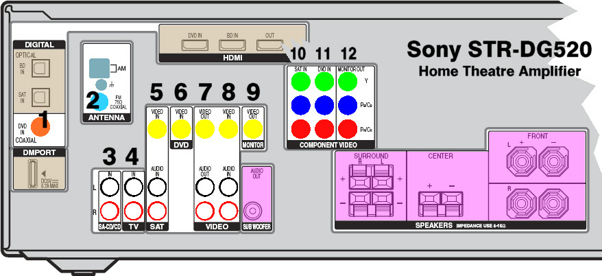

	Gunslinger I'll study what you've written viz PIP; meanwhile, I'm attaching a colorized picture of the back panel of my SONY STR-DG520 HT amplifier. To make this easier, I've numbered the columns on the banks of jacks that apply to my setup so there can be no confusion as to what you're referring to.
 Even more important, I finally aggregated every one of my components' respective jacks and they are listed, below.
 Any help you can give me will be gratefully appreciated! Once I get this down in writing, it will begin to make intuitive sense to me; but right now, I just need to go one step at a time since I have ((NO SOUND)) after trying a number of iterations of audio to the AMP.
 My hope is to be able to continue to record TV programs on both the VCR and the 8mm units.
 Thanks again, and here is what I have to work with!

	Start simple.
 1. White/Red/yellow from bank 7 on the amplifier connects to the matching colours on Bank one of your 7. This is the input to your TV.
 2. DVD player. For the best quality image and sound, connect the coax audio output of the DVD player to the coax audio input of the amp (marked 1 - DVD In Coaxial), then connect the component (G/R/B) output of the DVD player to the component input on the amp marked 11 DVD In.
 However, as you are using low quality composite output, this is probably overkill if you don't already have the cables. If you don't, connect the coax audio as described above, but connect the yellow composite cable from the DVD to the composite input marked 6 - Video In DVD.
 You should now be able to see and hear the DVD player on the TV via the amplifier, with digital surround sound.
 (I am assuming, at this point, that you have been able to connect up the speakers and sub-woofer).
 3. VHS VCR. Connect the yellow/red/white from the Bank 1 outputs on the VHS VCR to the matching colours in the bank marked 5 - Video In SAT - on the amplifier. Connect your aerial to the VHF/UHF in on the VHS VCR.
 Stop at this point and test that you have audio and video on the TV from the VHS unit.
 4. 8mm Recorder. Yellow/Red/White from the video should be connected to the amplifier bank marked 8 - Video in Video. Connect a coax aerial lead from the VHS VHF output to the VHF input of the 8mm recorder if you do not have a split set of aerial leads for both units. You will also have to connect an aerial coax from the VHF output of the 8mm to VHF input of the TV if you wish to watch it without turning on the amplifier and using the VHS for channel.
 You should now be able to switch between all three devices, record TV channels on both the VHS and the 8mm recordersRead my blog here.
	Believe me gunslinger, that's what I am trying to do. I'm just trying to get sound  any sound  out of my 5 speakers. And yes I do know how to wire the speakers lol. Believe it or not, I build my own computers.Originally Posted by guns1inger No  the problem is that what you and I both think is intuitively the way to cable this AMP . . . is anything but in the actual manual.  Read my next reply, and you'll get an idea of why this is driving me nuts. No  the problem is that what you and I both think is intuitively the way to cable this AMP . . . is anything but in the actual manual.  Read my next reply, and you'll get an idea of why this is driving me nuts.
 Okay, now . . . you do mean Bank one of your TV I hope (?). :P Just wanted to make sure you were still awake. Assuming that was what you meant  7 to the BANK 1 of my TV  observe what the SONY manual is telling me to do, and you'll get an idea of what I'm dealing with:Originally Posted by guns1inger
	Do you see how they are splitting out the naturally-grouped set of three cables . . . and throwing the video over to the right under "MONITOR" . . . and the audio all the way to the left! Wtf . . .
 MC
	Setting aside the madness of forcing a perfectly intuitive 3-Up set of video/audio cables to perform the splits, look at their graphic labeled A. It makes intuitive sense that this is the
 set of jacks that my TV has, separated from the other two 3-Up Banks (see above). Yet, when I contemplated which bank of jacks on my AMP to plug a pair of regular RED/WHITE RCAs into (3? 4? 5? 7? 8?) I tried a couple and . . . no sound.Bank Audio Out Variable/Fix

 Moving from that trainwreck to the next one, this page in the Sony manual displays their graphic labeled C. My old TV doesn't have these
 jacks, but my DVD player does. Should the DVD player be plugged into #11 on my graphic? If so, should I simultaneously be plugging in theY
 Cr/Pr
 Ca/Pa
 cables, as well? to . . . where?VIDEO OUT . . . YELLOW
 AUDIO LEFT OUT . . . WHITE
 AUDIO RIGHT OUT . . . RED
 SHOPPING
 I don't have any Y . . . Cr/Pr . . . Ca/Pa cables; should I buy them?
 I also don't have a COAXIAL DIGITAL AUDIO CABLE (#1 on my graphic); should I buy it? Will I need more than one?

	The setup they have will be, I assume, because they do not upconvert composite inputs to component output, and probably vice-versa. So even if you do connect your DVD using component, you won't see any benefit (and probably won't see any picture) until you upgrade your TV.
 In your case, stick with just using the yellow (composite video) and red/white (stereo audio) for all connections except the DVD audio. For that, use the coax digital so you can get surround sound. So yes, buy a coax digital audio cable, and no, don't bother getting a component video cable (red/green/blue).

 Should read1. White/Red/yellow from bank 7 on the amplifier connects to the matching colours on Bank one of your 7. This is the input to your TV.
 1. White/Red/yellow from bank 7 on the amplifier connects to the matching colours on Bank one of your TV. This is the input to your TV.Read my blog here.

 So, the reason why the banks of analog Y/W/R jacks on the amplifier aren't making architectural sense to me is because SONY is presuming that I'm connecting this to a state-of-the-art TV that would make use of either its built-in HDTV jacks -or- its built-in component jacks (Y  Cr/Pr  Ca/Pa) . . . and ignore the old analog banks on the AMP wherever possible? Ahhhh.
 To summarize only the DVD player:
 Do I have that correct?1. The DVD player at no time connects to my TV
 2. Attempting to use component jacks (Y  Cr/Pr  Ca/Pa) anywhere with my TV will void/scramble the picture unless and until I purchase an upconverting AMPLIFIER and/or a state-of-the-art TV.
 3. DVD's single-analog YELLOW VIDEO RCA connects to #6 on my AMP
 4. DVD's COAXIAL DIGITAL AUDIO CABLE connects to #1 on my AMP
 In regards to the COAXIAL DIGITAL AUDIO CABLE: I began looking for these last night and noticed that some of the better ones use fiber-optics. Will fiber-optics-stranded COAXIAL DIGITAL AUDIO CABLES work with my old equipment? or must I have a state-of-the art TV & DVD player to render this signal, as well (in other words, is it backward compatible)? I'm asking that because, even though I have old analog componentry, I'd nonetheless prefer to invest in cabling that is state-of-the-art . . . and let my componentry catch up with me later on (I hope that makes sense lol).
 Gunslinger I can't thank you enough for your help with this! I'll look forward to your reply and then . . . go shopping. :P
 MC
	There are two types of digital audio cabling: optical and electrical (coax). You use whichever your devices support. I see your receiver supports both but maybe only some types for some inputs. For example, the coax input is labeled DVD and the optical inputs are labeled SAT and BD. It might be possible to reconfigure them.Originally Posted by MISS CHIEVOUS
 The audio only needs to get from the source (DVD) to the Receiver. The receiver converts to analog and sends the signal to the speakers. But that means you must have the receiver on to hear the audio.Originally Posted by MISS CHIEVOUS
	You said your DVD player only has coaxial output for it's digital connection, so optical doesn't figure into the connections at this point.
 If you connect all your devices through your amp then you need to have the amp (receiver) on when you are watching or you will get no picture or sound. Everything routes through the receiver.Read my blog here.
