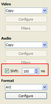

The audio sync tool in AviDemux is also simple and straight-forward.
Also if the audio "goes" out of sync gradually....just press stop then start again.
