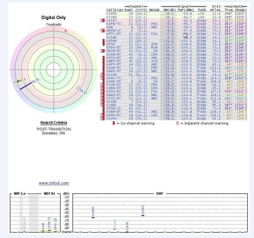

    According to TVFool, you have an obstructed but possible 70mi shot at Portland. 95-107dB will be problematic. You will need the largest antenna and a preamp. There are a few PBS translators around Hood River and The Dalles.
    Your situation is near identical to mine except I'm higher at 3000ft. TVFool is projecting 70-100dB gain needed here. I'm considering the same antennas. If I were you, I'd look for antennas in your community and ask the owner if they can get Portland.

    It looks like some KGW Ch8 signal reaches Snowden WA.
    http://www.tvfool.com/index.php?option=com_wrapper&Itemid=80

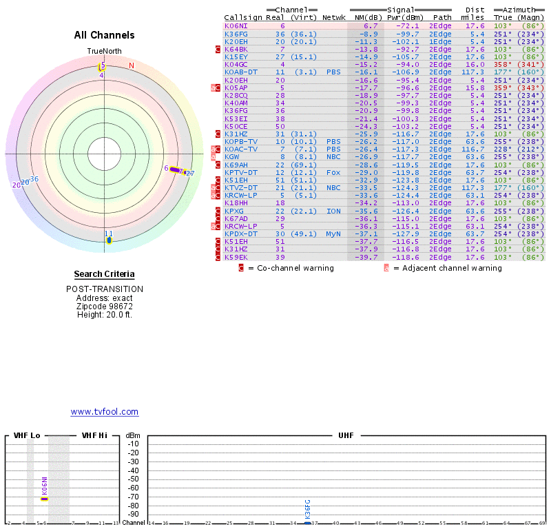

    I ran the TVFool tool again for the post transition results and I got a little different list of stations, possibly because I used my exact street address. Some of the stations were digital(in blue on the tvfool chart), but a number of the listings were purple, which I assume are some kind of analog repeater? A 2Edge signal path means the signal is coming over mountains, so that is going to weaken the power as well.

    Your listing basically eliminated Portland as a option. -117dB signal level is not likely to work. KOAB-DT (PBS) is in Bend Oregon. The rest are translators or low power stations serving local towns.
