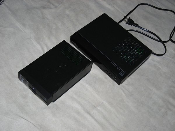

The Airlink ATVC102 is available from Fry's Electronics for $59.99, the Insignia NS-DXA1-NPT is available from Best Buy for the same price. The Insignia is the same as the Zenith DTT901 (both are made by LG). All these models have analog pass through.
[edit]The Airlink is now available from Fry's for $40.

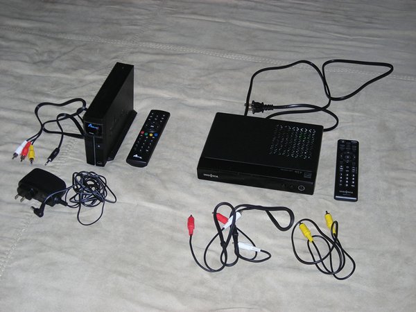

This photo shows the accessories with each model. The Airlink uses a special composite cable with a mini phone jack at one end and has an external power supply vs the Insignia which has standard composite cables with a built-in switching power supply.
The Airlink is about 1/2 the size of the Insignia and has a plastic foot so it stands vertically but the small size of the case is made up for by virture of the external power supply.

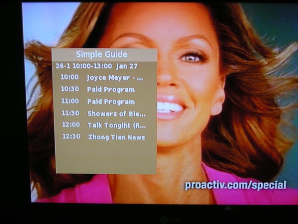

The Airlink does have a better EPG (electronic program guide) although it only shows the programming for the selected station.

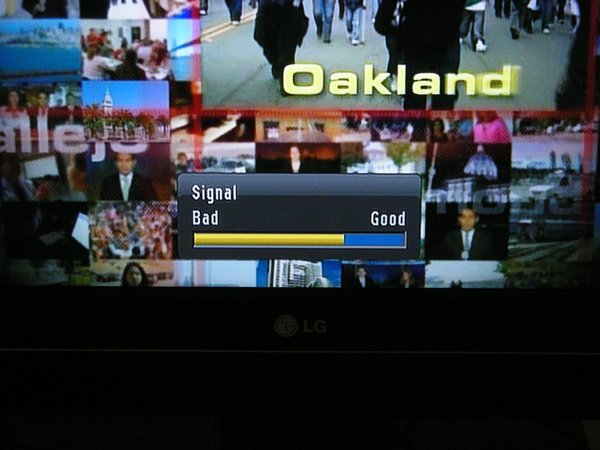

The tests were done with two different over the air stations; one broadcasting in SD and one in HD. The same antenna was used in both cases. The signal strength was in the "good" region or about 72% on the Airlink signal strength indicators.
Signal strength meter on Insignia
Signal strength meter on Airlink

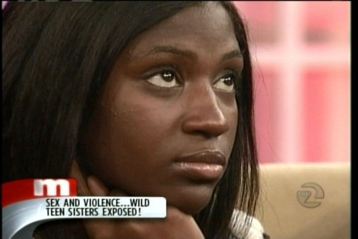

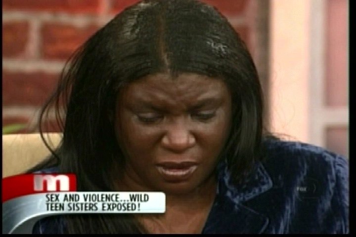

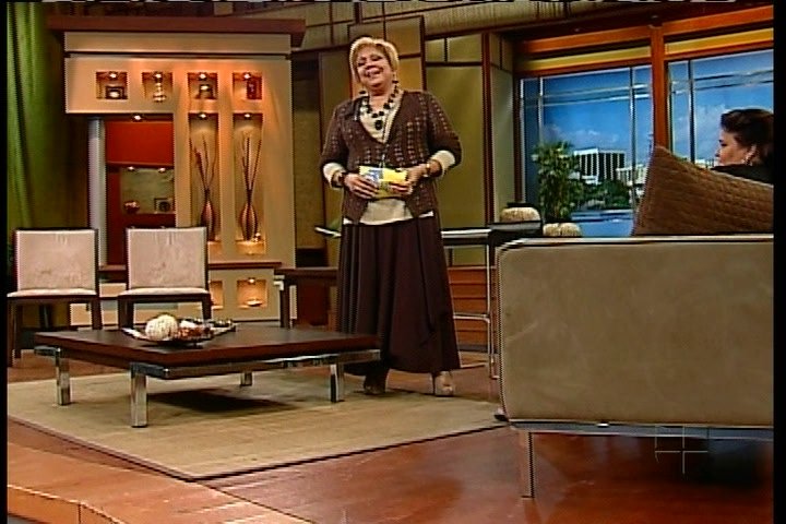

The tests with SD transmission show the Airlink and Insignia are comparable although during motion scences, the Airlink shows more macroblocking.
Insignia SD capture
Airlink SD capture

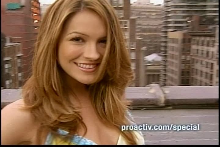

The tests with HD transmission show the Airlink is not as good as the Insignia showing jagged edges and blocking more frequently even in relatively motion free scenes.
Insignia HD capture
Airlink HD capture

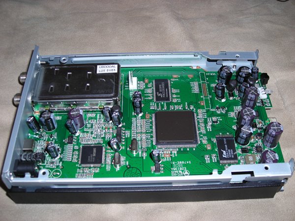

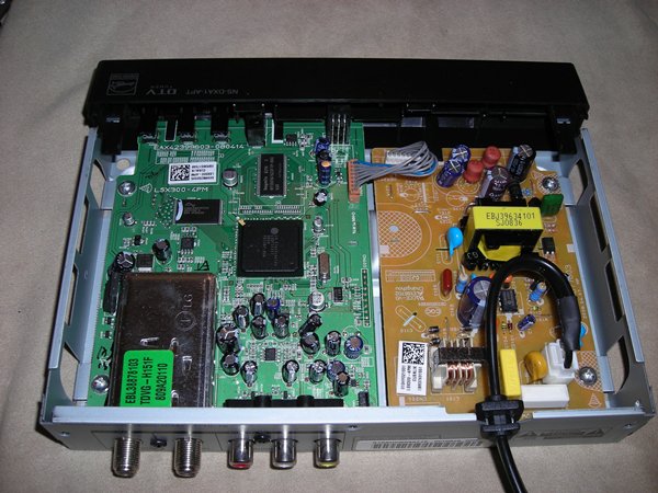

Here are some views inside the boxes. Neither gets very warm. The Airlink is slightly warmer to the touch but not hot.
Insignia
Airlink

The Insignia downconverts to SD with better quality than the Airlink but the Airlink has better guide and says on the box "Includes Electronic Program Guide (EPG) function with up to 7-day on-screen list of TV programs' information".
Having that sort of guide is not all that useful since it only shows upcoming shows. It cannot turn the converter on at the appointed time and tune to the correct channel.
There are some units that can do that. Both the TVPal and TR40-CRA units can but they have some pretty awful reviews for reliability. They are said to run very hot.
http://www.dtvpal.com/
The problem is that the guide only works on the unit itself and does not pass the information to the succeeding device like your EH50. There is discussion that they are working on that but hard to say if it will really happen. These Dish Network units are not easy to find in a store. -

The Dish Network units do allow programming to record from different channels at different times. The EPG turns on the converter and tunes to the correct station but the recorder following it has to be programmed to start recording at each appointed time separately since the recorder does not get the guide info from the converter.
