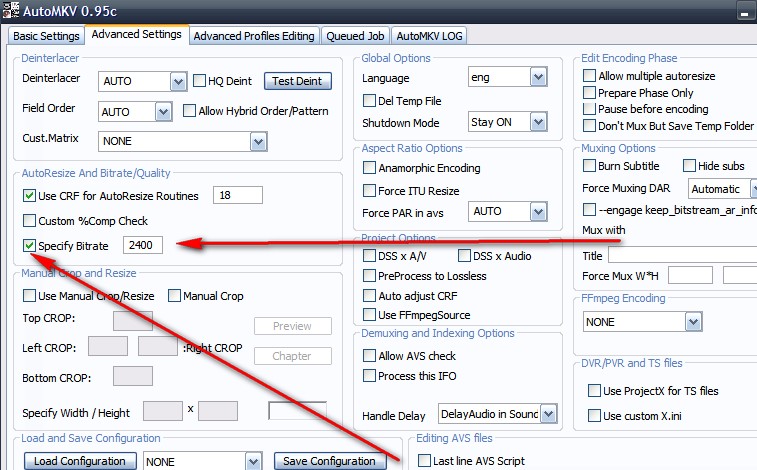

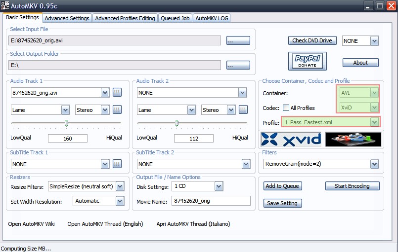

 1) Download and unzip the following file and copy the contents into your
 C:\Program Files\AviSynth 2.5\plugins\
 folder
 tempgaussmc_beta1.zip
 2) Download and Unrar AutoMKV 0.95C from here:
 http://wareseeker.com/download/automkv-0.95c.rar/3510789
 Copy the settings in green

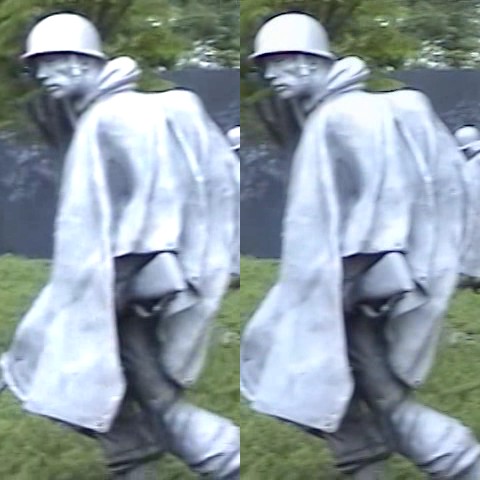

	I would pull the luma down a bit to retain a little more bright detail. Try adding this to your AviSynth script:
 ColorYUV(off_y=-8, gain_y=-15, gamma_y=40)
 Before, after ColorYUV():
 Use Cedocida as your DV decoder so you get YUY2 or YV12 output.

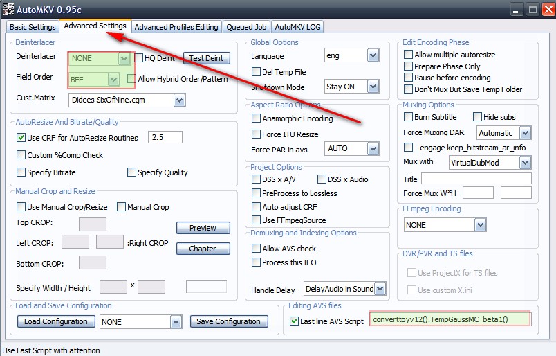

	Oh, sorry. All the same settings as above, except add this. And make sure you've added this verbatim to the Last Line in AVS Script section:
 ConverttoYV12().TempGaussMC_beta1()

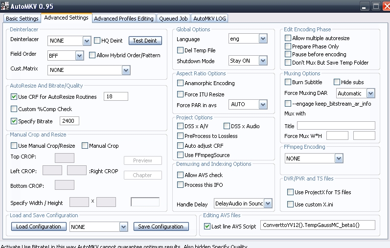

	On the advanced tab, the Deinterlacer setting are different on the two boxes you posted. One has None and BFF, the other has auto on both. Which should I use? Im still not getting near the results you did.
	You use none because you are manually adding TempGaussMC_beta1() at the end of the script.
