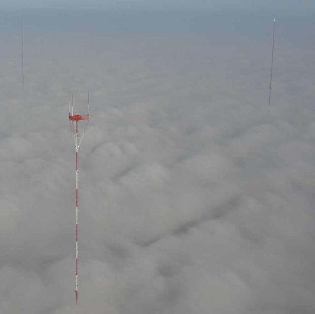

 CH13 antenna comes down, Ch25 antenna moves up.
 Looking down on the 1500ft backup tower from the 2000ft+ CBS/CW/ABC tower at Walnut Grove,CA.
 Other channels are on the towers in the background.
 PS: KOVR makes a good example for what is happening at other stations. Their old CH13 analog antenna was at the top of the main tower and the temporary DT Ch25 antenna was lower down that same tower broadcasting at 760kW ERP. They also have a separate backup analog CH13 tower and antenna. In Dec-Jan they are broadcasting analog from the backup antenna while lowering their main CH13 antenna and then raising an optimized DT Ch25 antenna to the top. On Feb 18 they will broadcast at 1000 kW ERP from the top of the main tower on DT Ch25 only (all this per FCC online documents).
 The fringe viewer will see a substantially improved DT 25 signal.Recommends: Kiva.org - Loans that change lives.
