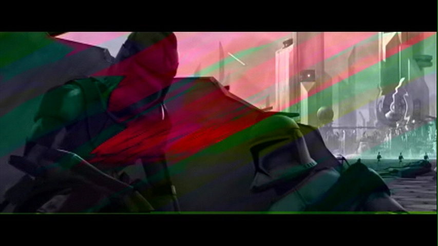

    I have been burning DVD's for a little while and I have run into a problem. Twice with two different movies, original format was AVI and played with no problem. Once I converted it to DVD the end product looks black and white with a rainbow effect. Im using 1 click DVD movie and this has only happened 2 out of 40 movies. Any help is appreciated.

    I will check again but this is a screen shot of my problem

  8. The height of your source video is mod2. Your MPEG4 decoder requires Mod4 and is screwing up the chroma channels when decoding. I don't know what decoder 1 click DVD movie is using. You might try converting the file to something else as an intermediate with VirtualDub -- say, HuffYUV AVI. Or try changing MPEG4 decoders. If you're using Divx, switch to Xvid, or vice versa.
