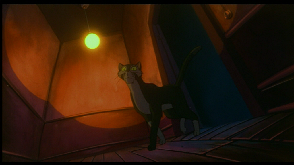

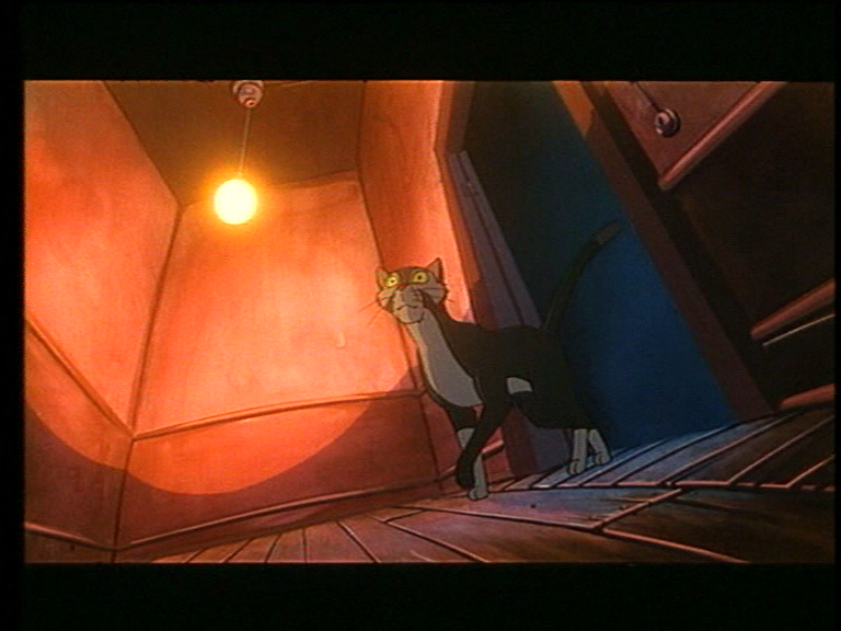

  6. Member waefwaeefwaefw's Avatar
    Feb 2008
    Ok I have now taken another way to make a snapshot and it's a png now maybe u get another result
    I post them as individual files
    from the trailer
  7. Member waefwaeefwaefw's Avatar
    Feb 2008
    from the movie

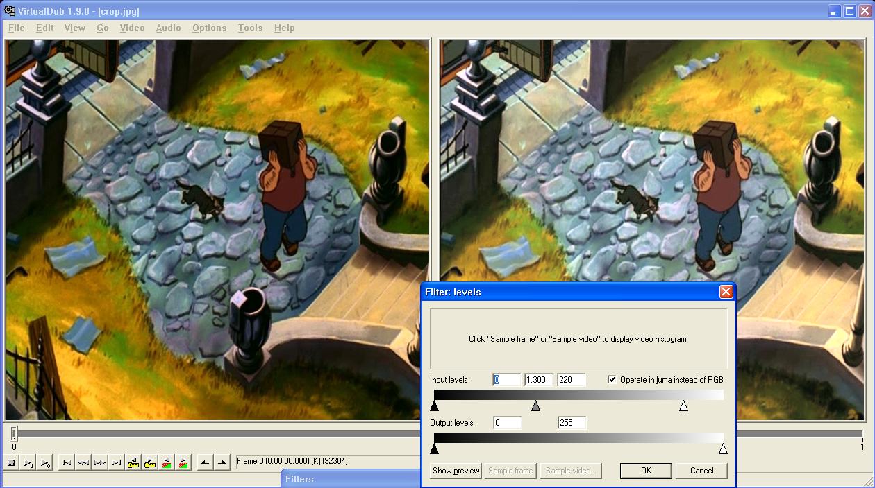

  9. Originally Posted by waefwaeefwaefw
    @jagabo
    How did you reach that levels it looks quite good but dunno, do u think it would turn out the same or the last two images I have posted!?
    I used the Levels filter to pull the black level down, the white level up (too much, like the other shot), and adjusted the gamma to bring out details in the middle. I also used Gradation Curves to bump the blue channel up a bit. The same settings will not work with the other shots.
    Your "bad" shots are all just about right for a professional DVD converted to computer RGB with the standard rec601 matrix (blacks level at RGB 0, whites at 255). If you want a more TV-like appearance for online posting adjust the gamma to about 1.3 and increase the brightness (white level 220 -> 255).
    If you want less saturation have the levels filter operate in YUV. If you want more saturation have it work in RGB. White level from 220 -> 255 may be a bit too much for other shots. You'll have to find a compromise for the entire movie or work scene by scene.

    PS I have found out that they have really changed the color of the cat during the production. Only the first 4-6 minutes it has that brownish and then it's changed to what it looks like thoughout the whole movie, that kind of grey. Strangely we can see that the cat in the real film is colored bluish grey from the beginning on and that again would bring me to the guess that they have maybe simply changed the whole colorspace for the benefit of the cat - what you guys think could that be!?

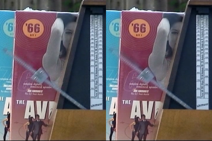

  29. There is one reason not to open an MPG file in VirtualDub directly: it doesn't handle the chroma channels of interlaced YV12 correctly. It treats the chroma channels as progressive thereby blending the colors of the two fields together:
    On the left is one field (simple bob) from an MPG file with chroma channels handled correctly. On the right is what VirtualDub does on conversion from YV12 to RGB. Notice how the gray bar is less gray and there is a gray "shadow" on the reddish DVD case (that's where the gray bar is in the other field of the frame).
  30. Member waefwaeefwaefw's Avatar
    Feb 2008
    So there even is a difference of a progressive film and a progressive chroma channel o.0?
