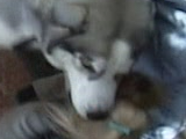

Are you sure? The lower resolution recordings will still fill the frame a 4:3 TV at playback. Examine one of your low quality VOB files with GSpot or MediaInfo to check the resolution.Originally Posted by L.Paton
As an example, the Panasonic ES15 records at 720x480 (NTSC) when set at the 1, 2, and 4 hour settings. At 6 and 8 hours it reduces the resolution to 352x240. Here's are some samples of 1 and 4 hour recordings of the same handheld camcorder footage. A small (160x120) portion of the frame was enlarged 4x so the difference in quality is very obvious:
