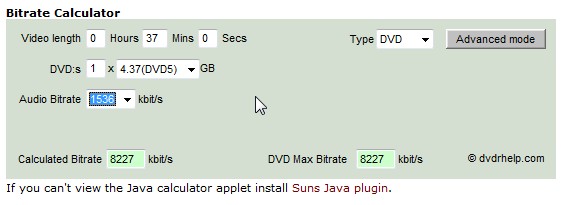

You can use the bit rate calculator to check for ideal bit rates for diffferent play times and audio settings. See https://www.videohelp.com/calc
For hand held DV camcorder material, I'd try to keep the average bit rate over 8Mb/s.Recommends: Kiva.org - Loans that change lives.
