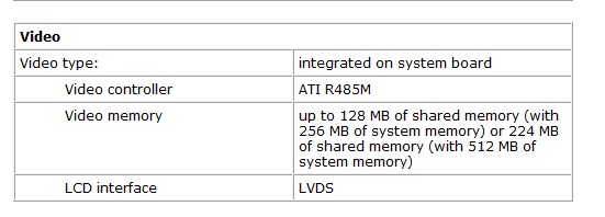

    its a dell vostro 1000. dual core amd 1.9ghz, 2gb ram

    That model has an integrated ATI R485M display chipset.
    They don't list output resolutions but display memory is very small unless you upgrade.
    The screen resolution is WXGA or 1366x768. That is probably your limit.
    http://support.dell.com/support/edocs/systems/vos1000/en/OM/html/specs.htm#wp1054574
