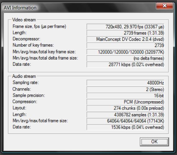

	Here are the specs for one of the files I am wanting to play. Does this confirm your suspicion that there is not a device available aside from a computer that I can connect to a tv and play this files as is?
	Yes. It is DV. Have you tried H.264? You shouldn't see significant loss, and it should open the door to more players.
 Maybe even high-bitrate DivX?
