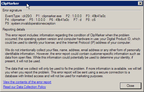

no no no, the zip file thing is perfectly fine, i meant by actually opening Clip Marker, it doesnt want to open and Microsoft gives the error message and the option to send report or dont send.
this is why i mentioned is it because i am using XP? -
Oh, right! Just downloaded and confirm I get the same thing (I'm using XP Home SP3). Here's a screenshot of the error dialog.

Hmm.
This will happen if you try to run the exe file from inside the zip file. The two files must be unzipped.
Also, check that the Enosoft DV Processor is correctly installed. Even if it is the wrong version, the program will run but tell you the version is wrong (i.e., it won't just crash).
Check that you have the right version of the .NET Framework installed (2.0 I think).
I've just confirmed it works on my XP SP2 laptop using the file on our server.John Miller -
its not running from the zip file, it is extracted, and your software pretty much is installed correctly, i opened it and runs fine.
and i also have .NET Framework 2.0 SP2 installed, what could be our problems here?
Ditto for me.Originally Posted by Undead Sega"Just another sheep boy, duck call, swan

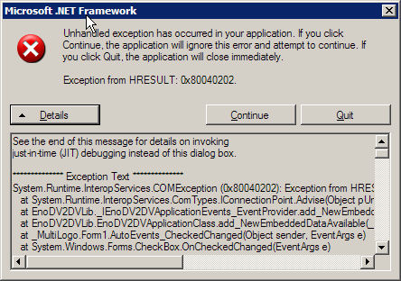

Of the Bin folder samples, Livestreaming gives the same crash error as Clipmarker, and Multilogo gives me an error dialog (shown in the image below), but seems to work if I click on the Continue button, all others work OK.
