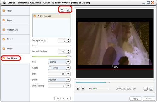

so I check xilisoft and it has 4 kind of 'mpg output'
1. MPEG-1 Movie (*.mpg) industry-level video format w/ VHS picture quality and CD-like sound quality<--I didn't use this one but it seems very similar to the one below so I guess I won't work
2. MPEG-2 Movie (*.mpg) industry-level video format w/ broadcast-level picture quality and CD-like sound quality<--I used this one but it obviously didn't work
[b]3. Super VideoCD - MPEG2 PS Format (*.mpg)[\b]
4. Video CD - MPEG1 PS Format (*mpg)
==>none of the above sounds like it will be DVD compatible so I guess Xilisoft is no good huh? if so, could you recommend something that is good for mkv to avi/mpg which is DVD compatible?
P.S: it also has the 2 'vob output'
1. DVD - MPEG2 PS Format (*.vob)<--since I heard somewhere that you can change vob extension to mpg extention in some case so I tried to convert the mkv using this option but it failed due to some error
2. VOB - MPEG2 PS Format (*.vob)<--I'm trying this one right now -

Are you still using Xilisoft Video Converter?
Then check that you do NOT use any of the HD encoding options:
I haven't installed Xilisoft Video Converter, but probably the DVD compliant options can be found within the profiles for 'General Video'. There you can check the settings for the profile in the 'Advanced Profile Settings':
Please use 720x480 resolution. This is the highest which is allowed on a normal dvd.GUI for dvdauthor:
