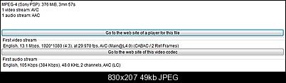

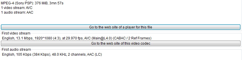

  17. I'm trying to edit my mp4, and it comes up with the audio decompressor error, although I installed ffdshow, AC3, AC3ACM, everything I can find. And I think it may be making it worst. Still same error. :/ It works perfectly if I remove audio. But kind of need it.
  18. I'm a MEGA Super Moderator Baldrick's Avatar
    Edit: Or wait...I doubt your mp4 has ac3 audio. What is the audio the in mp4? Identify with mediainfo if you don't know.

    I have ffdshow installed, with the AAC codec enabled. So :/

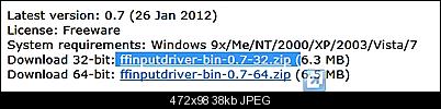

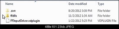

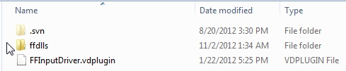

    The easiest way to get MP4 with AVC Video and AAC Audio to play in VirtualDub is go to http://codecpack.co/download/FFInputDriver.html and download the FFinputDriver.vdplugin filter. The download link (32 bit) is near bottom of page:
Name:	ScreenHunter_463 Jan. 24 08.12.jpg
    Unzip contents and place the contents in the Plugins32 folder of Virtualdub:
