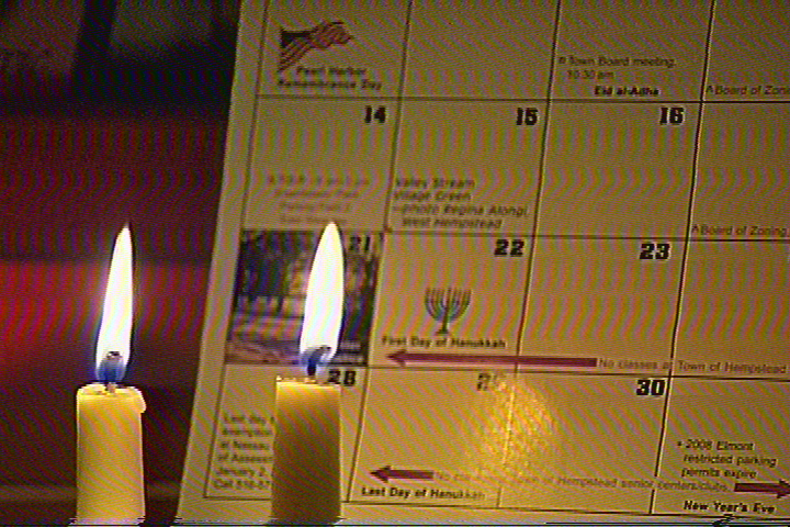

    1) Its S-video output is showing up a lot of chroma noise lately, especially in the form of diagonal red/blue twitching lines grouped in top-down-moving bars, like those in the attached image.
    2) also the front display has faded out almost completely; I heard that this is common in old-age AG 1980 vcrs and most likely caused by failing capacitors, so replacing capacitors would be in the order-of-the-day;
    3) and most importantly, the sound output has just suddenly failed, so that since yesterday I no longer have sound at all (not even a hissing) from the front phone plug (even with the phone vol maxed out) nor from the rear RCA right/left audio output plugs; I suspect another capacitor or power transistor.
    Does anyone else here have already seen something like the chroma noise in (1), especially in an AG 1980? Any idea on what might be the cause? And also the causes of (2) and (3)? Maybe someone would be able to point me to some service manual, so that I could, if not repair by myself, at least have an idea on what could be the cause of such problems. Or to some tried-and-tested repair service centers for this VCR model that I could sent to; I guess that it could be anywhere in the world (US, Europe, Japan etc), since nowadays it is a bit too much to expect more than a couple of specialized repair centers in the whole world for this VCR...

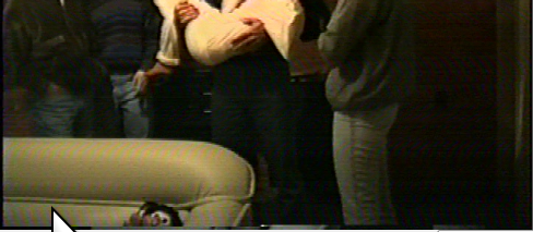

    Found the following while running an Ebay search for the same model. This seller was selling the unit for about $15 due to the following description: "Everything works great on this machine, from tape handling to still frame, except it plays back with a carrier leak (herringbone beat) interference pattern".
    A further look reveled the following image below, describing what the herringbone effect is and how to service it.
  8. Isn't there a specific switch on the Elite Video BVP-4 unit designed to counteract herringbone patterns? I wonder if that could help at all.
