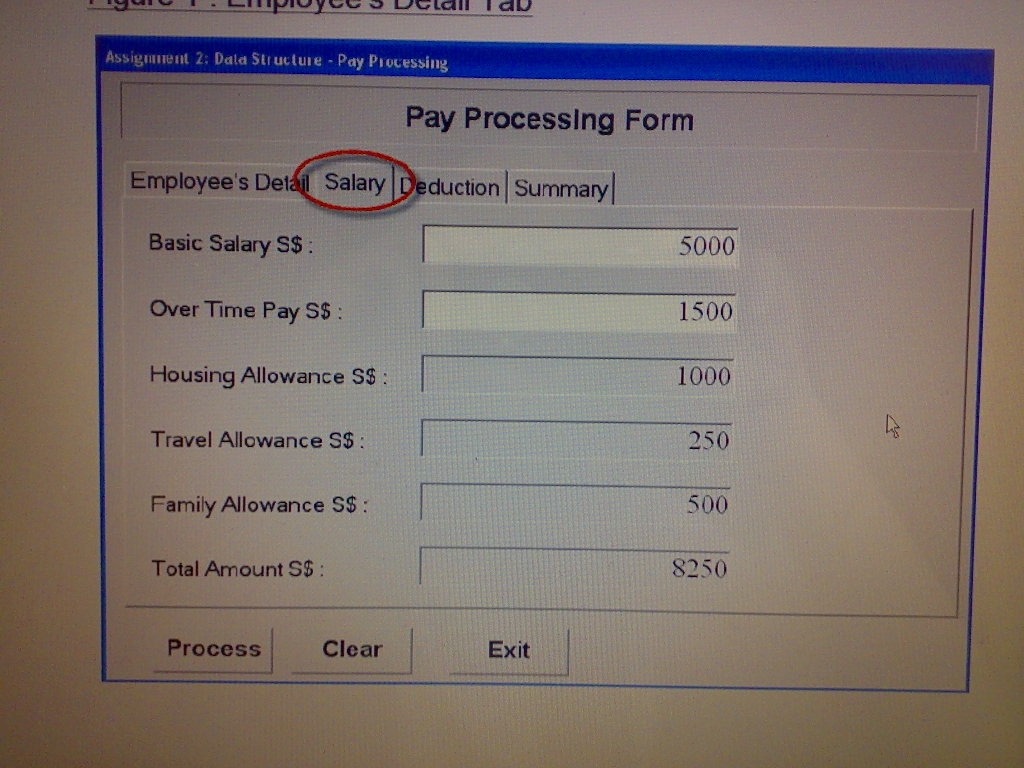

Can tell me what's wrong with this code? This code doesn't seem to works and it pop up a thing that says INVAILDCASTEXCEPTION WAS UNHANDLED and it highlighted the statement of txtHousingAllowance.Text = txtBasicSalary.Text * 0.2 this. So can tell what the problem with it?
I am really struck with It. U are an expert in vb programming, can u help me to write code for me or u can mofify it if u dun mind..... In the second post i have the pic in but i dun noe how to write the code......
For the housing allowance: 20% of the basic salary
For the travel allowance: 5% of the basic salary
For the family allowance: $500
txtTravelAllowance.Text = txtBasicSalary.Text * 0.05
txtTotalAmount.Text = Val(txtBasicSalary.Text) + Val(txtOverTime.Text) + Val(txtHousingAllowance.Text) + Val(txtTravelAllowance.Text) + Val(txtFamilyAllowance.Text)
Another code is this it also had the same problem.
If txtCPFContribution.Text = 20 Then
txtCPFDeduction.Text = txtBasicSalary.Text * 0.33
ElseIf txtCPFContribution.Text = 18 Then
txtCPFDeduction.Text = txtBasicSalary.Text * 0.27
ElseIf txtCPFContribution.Text = 12.5 Then
txtCPFDeduction.Text = txtBasicSalary.Text * 0.185
ElseIf txtCPFContribution.Text = 7.5 Then
txtCPFDeduction.Text = txtBasicSalary.Text * 0.11
ElseIf txtCPFContribution.Text = 5 Then
txtCPFDeduction.Text = txtBasicSalary.Text * 0.085
End If
txtTotalDeduction.Text = Val(txtCPFDeduction.Text) + Val(txtInsuranceDeduction)
