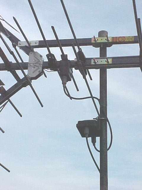

PS: The good preamps (e.g. Channel Master and Wineguard) mount up on the antenna like this. There is a power supply that goes indoors.

First, NO, a video amplifier will not help. That is the first response.
An RF amplifier may help. As has been noted, It depends on the signal you are getting from the station, distance, antenna quality, feedline quality, obstructions between antenna and transmitter, objects which can give multipath reflections which diminish a digital signal, etc. Welcome to the world of digital RF.
If you put an RF (not video) amplifier in the line, it should be at the antenna as edDV noted. You want to increase the signal before the noise, not amplify the noise along with the signal.
If you get too much signal, that will cause tv's to be overloaded and that will show up as no signal.
If the antenna is old, you might want to replace it with a new better one. Same with the feedline. Corroded antenna terminals and improperly routed coax can also cause problems.
