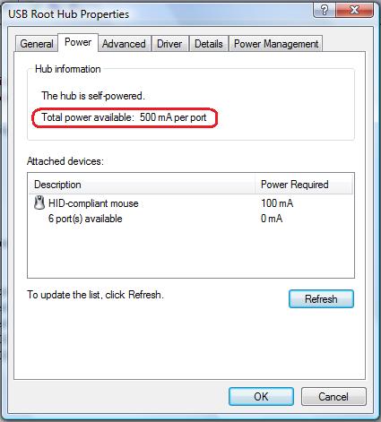

Just to add, a computer USB port usually limits the power to 500MA, about half a ampere. That's usually not enough for a 3.5" HDD. I have two 2.5" external HDDs and one of them won't run from just USB power.
Also if you plan to use that drive with a DVD player, you could damage the player if it doesn't properly limit the current draw. I would just plan on using a power brick if you want to use a 3.5" HDD.
Also, USB has only 5volt power. Most 3.5" drives need the 12volt power supply as well. If you need 3.5" drive, you will have to plug into a power source too.
