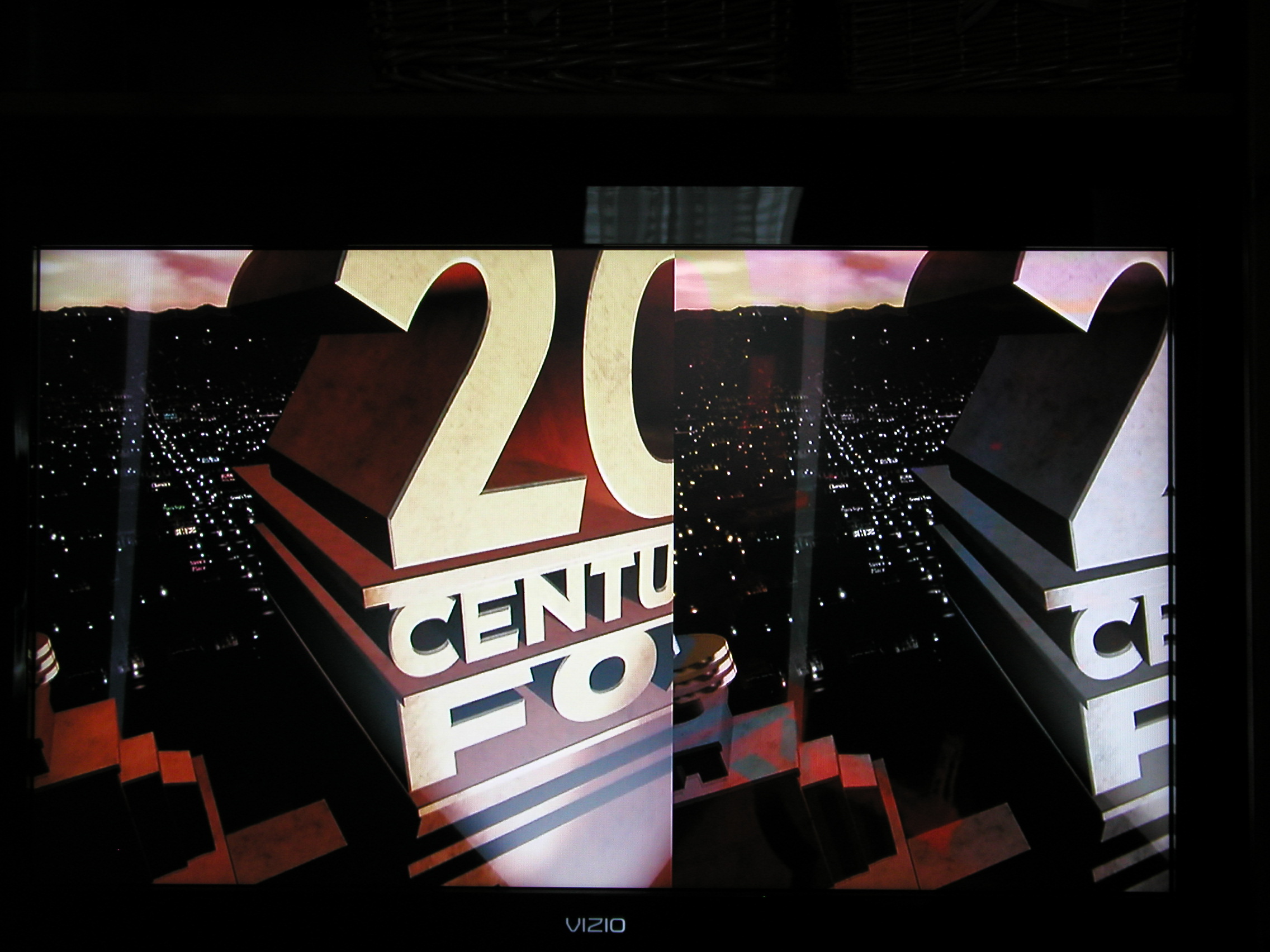

After burning the BDMV folders (using Imgburn, UDF 2.5) to a DVD DL disc I got "splitscreen" image on my LCD TV (left half of TV full color, right half is offset of left but in light blue/gray). Playback on my PC using both VLC and Nero Showtime were fine.

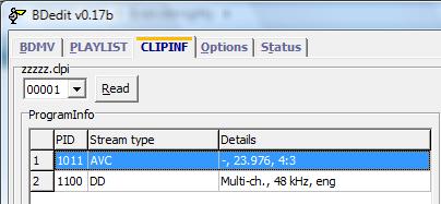

After searching the web I dl'd and used BDedit to check the structure and saw that in the .bdmv the vertical resolution was not shown. In the .clpi, the AR was shown as 4:3.
I tried searching for the term "4:3" in the index.bdmv files but it came up with no hits. I would really appreciate some assistance or pointers as to where to look to resolve this.

 What I did was to clip (remove) the black bars that were inserted by the DVR during the transfer to my capture app. My situation is that in the CLPI file, the AR is reported as 4:3 but displays correctly as 16:9 on my PC monitor, not on my widescreen TV. I assume (naively?) that the DAR in the CLPI file is causing the issue at the BD player.
 I'll have to try find a way to change what is in the CLPI file to see whether that is *really* the cause of my issue. After 6 coasters and a week wasted I am frustrated.
