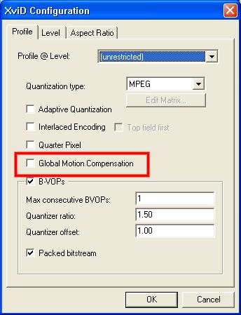

Some Divx/Xvid playback devices claim to support GMC, but tests have shown that they support GMC if only 1 warp point is used. I've never seen a playback device that supported 3 warp points. People who use GMC when encoding usually use 3 warp points. Just an FYI kind of thing that I think relates to the topic at hand. I agree with jagabo that it's generally best to avoid using GMC and QPel when encoding as those can be problematic for some playback devices. If you use them you need to understand that while your DVD player might be OK with them, if you give a copy of a file that uses those options to a friend, his DVD player may not play the file at all.
Thanks for the insight into why using avi recomp removes GMC.
I can see from the avi recomp screen that it uses the services of virtualdubmod (installed I believe in the avi recomp directory structure), avisynth, and xvid (1.1.3 final), but I can't see how to bring up the same XviD config screen that you show in your post. I do have entries in all programs for xvid, but nothing I choose takes me where you've been.
I think it would be useful to be able to check this out, and I certainly think everyone should check their xvid setup before encoding, to avoid producing a movie file that can cause problems and rework later, for no apparent benefit that I know of, yet anyway...
But still learning...
Edited because I just noticed the last flag in the picture, packed bitstream, which is checked, if that's the same as was mentioned earlier in this thread. I wonder if any other default settings also need to be looked at...
This must be covered somewhere... -
I don't know if AviRecomp gives you access to the Xvid config dialogs. I just use VirtualDub (and AviSynth if necessary) directly when I need them.
Packed bitstream with one b-frame isn't a problem for most players. -
AVI Recomp locks the user out of most codec settings because it's aim is to produce files that are playable in the widest range of hardware based players. Letting users into the codec settings defeats this purpose, so they don't. It is a very narrow, single purpose tool. If you want to play with the settings then you have to learn how to use virtualdub directly, instead of through an alternative front-end.
