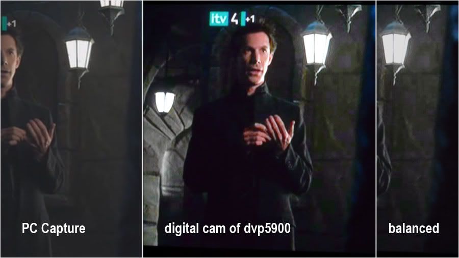

Here's a cap from my pc, and along next to it, a pic I took with my digitial camera, hoping to compare them
The digital camera caps aren't going to 100% represent what we see on the plasma of course, but if you look at the wall on the figure's right, you can clearly see green and dark purple patches I'm talking about.. they ARE more pronounced in the digital camera's pickup, so I tried to balance that pic in the rightmost version, and if you compare that with what we see on our pc here, you can still clearly see the green and dark purple patches as well.
(If you look VERY closely, you can also stil make out the green and purple splotches on the wall, but off the pc, they are no where near as apparant.)
I'm wondering if there is some setting on the player I missed setting up properly for our plasma.. it's 720p, btw.Gary Tabar Jr.
