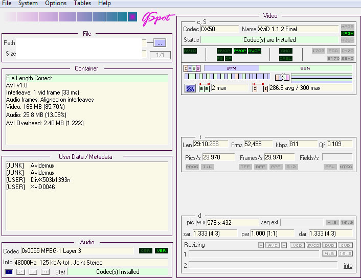

    here gspot:

    Originally Posted by the_shyguy
    ...in MPC it comes up with the chunk viewer...
    Sounds like the AVI chunk index is missing/corrupt. Try loading it into VirtualDub & just doing a direct stream copy on both the audio & video streams...VirtualDub will re-mux the streams & rebuild a new index.
