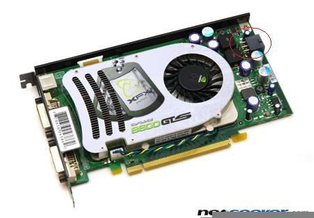

The supplemental connector would be the 6 pin PCI-e, as noted here.
Refer to the following photo for the connection point on the card:
Obviously, you'll have to open up the case to do so, and the card will be upside down (as compared to the photo), ie: the connector should be closest to you just beyond the metal retainer bar on the card.
The 500w should be more than sufficient for the system. Hell, a good 400w should be enough. My $$$ on more like the Idiot Squad and Worst Buy didn't hook up the PCI-e. -

You are a godsend Kush I fixed it, the PCi-e slot was not hooked in just like you said.
you do not need to use rubber gloves when you open up the case, just make sure the pc is off (obviously), as was pointed out the only time you see that message is when the video card power connector is either not connected or lossly connected (the more likely of the 2 scenarios).Originally Posted by Hogie
in either case simply make sure you plug it in as firmly as you can (you should hear a slight click as one side of the connector will have a small clasp).
