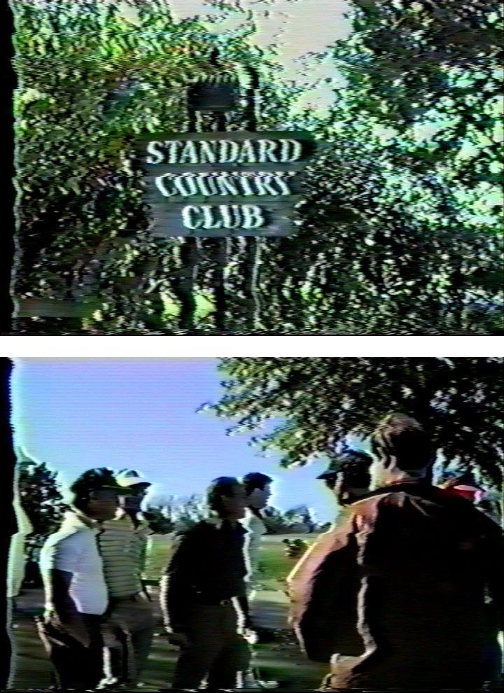

    I have a vhs tape from the late 80's I am trying to fix for my father-in-law. These are pics from the video I captured. I used a JVC S-VHS SR-V101US and a Datavideo TBC1000 along with an ADS Pyro A/VLink into WinDV. A low-end setup but that is what I have to deal with.
    However, I now would like to purchase once piece of hardware to help. Somewhere in the $300-$450 range. What do you suppose would be the best unit to buy? I was considering the Signvideo PA-100 or maybe the DR1000. Or is there something else you would recommend?
    First think I would like to correct are the wavy lines. The second thing would be for color correction if possible. This would not be the only tape I need to fix either.

    This looks like a second or third generation tape to me, so there may not be much hope for getting rid of the wavy lines at this point. In any case the Signvideo PA-100 or DR1000 won't do anything for you in regards to the lines. If your JVC TBC isn't helping things, you might want to try a Panasonic DMR-ES10 (check eBay - you can get them pretty cheap) as a passthrough device to your DVD recorder, as those have been known to fix these sorts of disturbances with a special set of filters in that deck.
    Mar 2003
    If the JVC TBC/DNR is turned on, turning it off may actually help.
    Try it in the JVC< turn on the stabilizer.
    Odds are the JVC will choke on this error, if the TBC fails.
    Panasonic DVD recorder or VCR may help.
    How many tapes have you got? Paying a restoration service may be more economical.
    These errors can be quite a nuisance, and it often takes many tries to get it to stabilize long enough and well enough to be converted to a digital format.

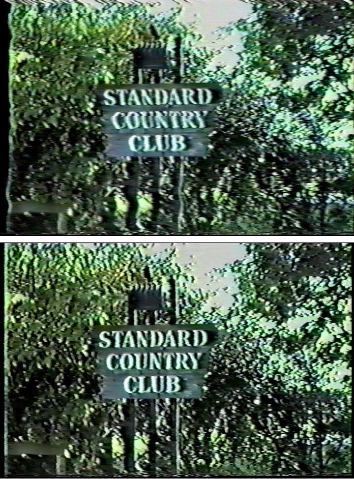

    Thank you very much. I took your advice and won a bid on ebay for the Panasonic DMR-ES10. All I can say is WOW! I rerecorded the video and it works great.
    I was a little skeptical at first. Then I started reading a lot of the past reports from this site regarding this machine and thought I'd give it a try. I am sure glad I did. Now all I have to get is an image detailer from SignVideo. Yeah, like my wife will let me spend the money on that.
    Here is an example of the same exact frame before using the Panasonic and after. Notice the word COUNTRY and the left side of the picture. Thank you again.
    Steve G

    Bravo! That thing is amazing sometimes!
    Detailer won't do anything for you on bad videos. Save it for clean SP mode recordings only. Vidicraft ones can be cheaper. One of my Studio 1 devices ran a whopping $50 some years ago, but I know I got lucky on that (the seller didn't know what it was, and the auction description sucked -- but it had a good image of the item!).
