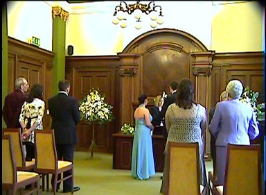

Hi guys. The camcorder is a Samsung miniDV VP-D70. There wasn't a filter on the lens when the video was shot. I tried WinDV but the problem remains. There is also a line that goes right down the right-hand side of the frame. I've attached a pic so you can see what I mean. I really appreciate the help as I'm a novice.
What you are seeing is vignetting caused by the zoom being at its widest and picking up the inside of the lens. The line down the side is also quite normal.
When displayed on a TV (directly from the camcorder), you never see these things (nor on the LCD monitor) due to so-called overscanning. Consumer CRT TVs are pretty inaccurate beasts and all of them deliberately magnify the picture slightly to ensure that the edges of the picture aren't within view.
You'll need to experiment with how much to zoom in a little to hide the vignetting. My HDR-HC1 does the same thing when I have a telephoto lens attached and the LCD monitor won't show you the whole image (so-called underscaned) - it's a pain in the proverbial bottom.
Note, if you are ultimately going to DVD and intend to watch it on a regular TV, you can leave it alone since the TV will overscan. Even plasma/LCD TVs do a form of overscanning in order to maintain equivalence with older analog consumer TVs.
WMM isn't doing anything wrong here...John Miller -
