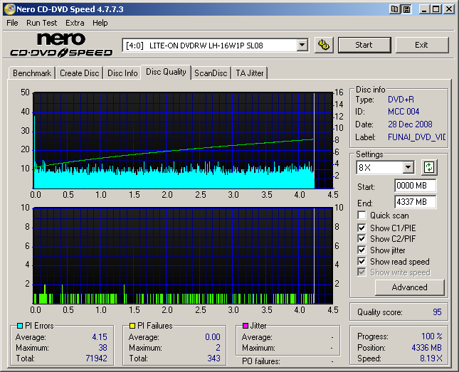

    Regarding the burn quality of the Philips 3576H, I see no problems with Verbatim 16X +R.
    Takes about 30 minutes to burn a full disk. They play fine on all my DVD players. Copied one using ImgBurn...97% capacity....took about 6 minutes to write the image to my "C" drive.
    Disk scanning seems most useful for confirming bad disk quality after it is first detected by playing or ripping the disk.
    Here's the data and an image file from Nero CDSpeed using the last DVD burned:
    Nero CD-DVD Speed: Disc Info
    Basic Information
    Disc type: : DVD+R
    Book Type : DVD+R
    Manufacturer: : Verbatim
    MID : MCC 004 000 (00h)
    Write speeds: : 2.4 X - 4 X - 6 X - 8 X - 12 X - 16 X
    Blank Capacity : n/a
    Extended Information
    Layers : 1
    Write strategies : 4 X
    Disc Status : Closed
    Raw Data
    Physical Format Information (00h)
    0000 - A1 0F 02 00 00 03 00 00 00 24 E3 2F 00 00 00 00 - .........$./....
    0010 - 00 00 07 4D 43 43 00 00 00 00 00 30 30 34 00 38 - ...MCC.....004.8
    0020 - 23 54 37 12 02 54 6C 02 92 5F 15 15 0B 0B 08 08 - #T7..Tl.._......
    0030 - 01 19 1B 0C 0C 0C 0D 01 00 00 00 00 00 00 00 00 - ................
    0040 - 01 00 38 38 02 2C 5A 1A 05 2E 23 10 04 1E 1D 01 - ..88.,Z...#.....
    0050 - 00 00 02 2C 5A 1A 05 2E 23 10 04 1E 1D 01 00 00 - ...,Z...#.......
    General Information
    Drive: LITE-ON DVDRW LH-16W1P
    Firmware: SL08
    Disc: DVD+R (MCC 004)
    Selected speed: 8 X
    PI errors
    Maximum: 38
    Average: 4.15
    Total: 71942
    PI failures
    Maximum: 2
    Average: 0.00
    Total: 343
    PO failures: n/a
    Jitter: n/a
    Scanning Statistics
    Elapsed time: 9:40
    Number of samples: 114511
    Average scanning interval: 1.21 ECC
    Glitches removed: 1
