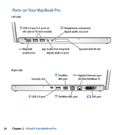

Mini-DVI is not standard on all pre unibody MBPS, the Mini-DVI out,
first popularized with the Mac Mini, and then added to the 2006 Xserve lines as well
as the lower end Macbooks, NOT
the Mac Book Pros, did not become standard
on MBPs, as MBPS, including the one I'm typing this on (2007, 2.2ghz model)
has the Dual Link DVI port on the upper right side.
The manual, which I also have handy, shows where the port is.
Apple decided to phase this out
in favor of the Mini Display Port, which is now common on the Unibodys.
other links:
http://www.everymac.com/systems/apple/macbook_pro/stats/macbook_pro_1.67.html
http://www.everymac.com/systems/apple/macbook_pro/ports/macbook_pro.html
simply put, a 2006 (1.6 to 2.0 Intel) and 2007 (2.2, 2.3) model MBP uses Dual Link DVI.
An early 2008 MPB uses Dual Link and a mid summer/late 2008 MBPs are Unibody and use Mini Display ports.
Picture worth a thousand words:

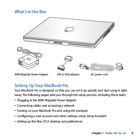

there would not be an extender cord in the box,Originally Posted by Cyrax9
not for a Macbook Pro.
Simply put there should be the DVI to VGA adapter.
You'll need to go buy the Radio Shack cable I mentioned four posts up
to run it to the TV from the adapter to the TV, if your TV's VGA port is
in the lower back end ( like the Toshiba's I've hooked up).
If your lucky and it is on the side of the Sony tv you have, then the 3inch DVI to VGA
adapter included in your box will reach and connect.
With the MBP sitting next to the Toshiba 42 inch TVs I've connected to,
the distance is almost a foot ( roughly 12 inches) from the adapter to the back of the tv, or if the
MBP is turned at 90 degrees west, then you can get by with 6 inches of cable.
Since those I've hooked this up for want both TV & MBP facing them
directly, which makes for excellent use of using the Front Row remote
in this setup, then a 15ft cable was necessary to hook up from adapter to
TV.
