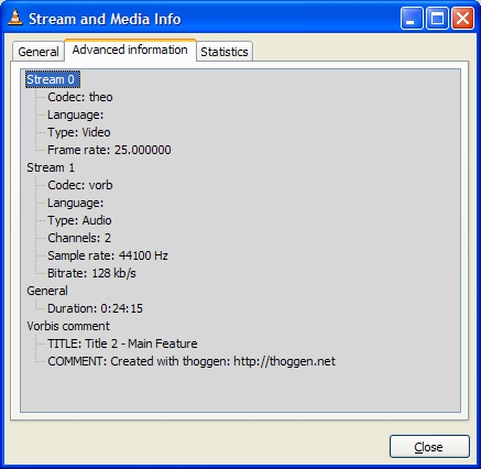

    Ok, I've tried everything I can find on this and it has me stumped. I have a few OGG (not OGM) files that have Vorbis audio and Theora video files in them. I need to have them in AVI/MP3. Tried VDM but it crashes with an out of bounds memory error. Tried OGGDemux but it says the video stream doesn't begin with a valid header. The files play fine in VLC, but I'm burning them to disc to play on a DIVX compatible DVD player. I've tried converting them to MKV and then extracting - nothing. Tried All To AVI - nothing.
    Anyone have any ideas on this?
    Thanks much!!!
    --- DS
    (I added a screen capture of the stream info from VLC in case that helps)

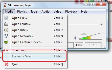

  4. Mod Neophyte redwudz's Avatar
    USA
    Though it's not the best solution, if VLC can play them, it may also be able to transcode them to a different format. Try under 'Media>Convert/Save'.

  7. Mod Neophyte redwudz's Avatar
    USA
    I'm using a newer version 0.9.4.0 of VLC, but the older versions have the setting in about the same place. I think it also has a 'Wizard' to assist setting it up.
