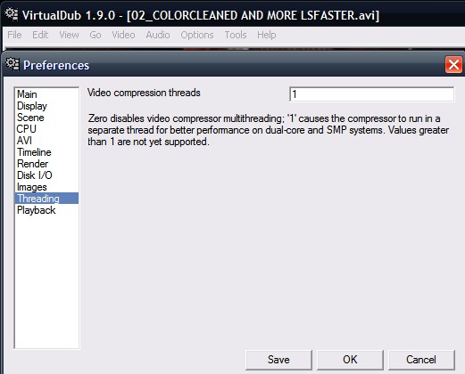

    It's news to me at least. I don't when this feature was added to Vdub, but you can find it under
    Options---->Preferences

    It was added in Build 29808 (version 1.8.1)
  6. In practice, about the only time you see a significant difference from that setting is when you are using an inefficient (not well multithreaded) encoder and a moderate amount of filtering.

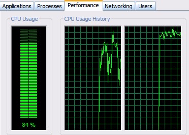

    If you use CPU intensive tasks, multithread helps. Example: Neatvideo filtering and x264 encoding.
  8. A multithreaded encoder will run multithreaded regardless of the threading setting in VirtualDub. What that setting does is run the filter chain in a thread separate from the encoder. That allows filtering to overlap with encoding. But if you have a well multithreaded encoder like x264 running another concurrent thread will not result in improved performance because the encoder is already using all the CPU it can get.

    In my case I have a boost. Around 30%
    my CPU is a C2D6600 and I use winxp
  10. I find Xvid can only use about 75 percent of a dual core CPU. That leaves 25 percent available for filtering. So using the Threading option in VirtualDub should increase the speed when using Xvid -- depending on how much filtering you're doing.
