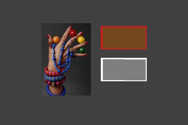

Here is an MPG file that shows the problem unambiguously:
720x480.zip
One frame correctly decoded and displayed:
Notice how the red/green and black/white horizontal lines are exactly one pixel thick.
When viewed field by field you should see a green box that bounces from side to side in the red area. Directly below it is a black box that bounces from side to side in the white area.
Crops of the two fields:Code:Mpeg2Source("720x480.d2v") AssumeTFF() Bob()
When viewed on an interlaced TV you would see the green and black boxes bounce side to side 60 times a second. Of course, this is very fast so it just appears as a flicker. Here is what it looks like slowed down to 2 frames per second:
If you open the MPG file directly in VirtualDub (with MPEG2 source plugin) you will see this:
Notice how the red and green scanlines have blurred together. The colors of the two fields have blended together. If you bob this the green/red section of the two fields will look almost identical -- no bouncing green box. The black box will continue to bounce because the luma channel isn't subsampled the way chroma samples are. The green and red colors were chosen so the the luma in YUV space is nearly identical. I believe the slight horizontal striping you can see the the red/green patch is due to the luma not being exactly identical.
Using DgIndex to decode to YV12, VirtualDub does this:
You can see red and green horizontal lines but they are now two pixels thick and not as pure as they originally were. This will not bob correctly like the earlier example:
Notice how the black box is still clean but the green box is messed up.
Converting the YV12 to RGB in AviSynth with:
Gives the correct image, the first image above.Code:Mpeg2Source("720x480.d2v") ConvertToRGB(interlaced=true)
The effects are much more subtle on the photo realistic part of the frame (provided as a sanity check). And, in fact, incorrect handling actually looks smoother at times (this is why I use test patterns for this type of test). But keep in mind that moving parts of the picture will be messed up, even if the static parts of the frame look a little better.
Beware of drawing any conclusions when viewing the MPG file on a computer monitor. Media players and display drivers are likely to screw up with interlaced video. -
Once again, the chroma subsampling bug we were discussing is in VirtualDub, not Divx.
I just verified that Divx (when it receives properly interlaced video to begin with) handles interlaced video properly. -
