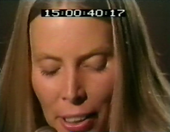

I have included a screenshot of the video.

These instructions seem to be for merging two videos. How does this explain the process of covering a time counter?Originally Posted by terryj

The footage that the OP (Mark) posted in post 3, if this is the exact
positioning of the time code in EVERY frame of this concert,

This is the exact place where the time counter is throughout the entire video. Even over the opening credits. Naturally, it is video so, sometimes it appears over her head and sometimes in an innocuous position. I tried exporting in widescreen - 16:9 but all it did was stretch the video. The full frame was still visible including the time counter.

and actually, terryj didn't imply 'stretching' the video to make it widescreen.. he suggested placing black bars at the top and bottom, creating a 'letterbox' type widescreen effect, which would cover the counter, but would also cover a stripe along the bottom.. possibly not desirable to you though, as you would be losing quite a bit of video.. (like her mouth in this example)

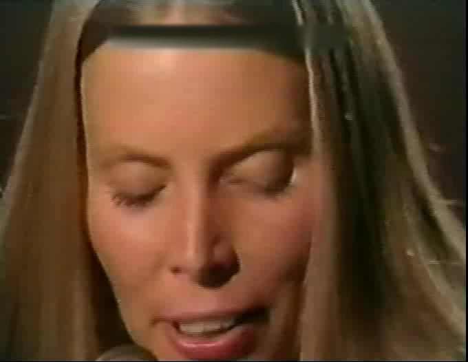

Well, if you do want to go to the dark side:Originally Posted by Mark-Leon
This is the result of using the Xlogo filter:
Xlogo tries to blend in the surroundings to fill the masked area; usually it's less obtrusive. Unfortunately, having the logo (it's not really a logo, but can be treated as one) on the face is about the worst possible place.
See https://forum.videohelp.com/topic333648.html for the gory details.
The script used was:
with a simple mask that covers the timecode area:Code:AVISource("picture8.avi",false) xlogo("time_x_154_y_26_2.bmp", X=154, Y=26, alpha=0)
