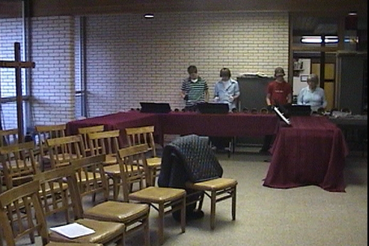

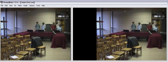

I was wondering if it's possible to do this with Virtualdub. My friend has a damaged portable player. The problem is that 30% of the left side is unwatchable. Something like this:
So I was wondering if there was a way with Virtualdub to put some sort of black bar on the left side of the video. That way It would only use the watchable portion of the screen for videos.

Yes, VDub can do it with resize (with letterbox) and then crop the excess. You'll have to experiment with it to figure out what to resize it to and it will probably have a negative affect on quality, but it should be doable.
Buy My Books -

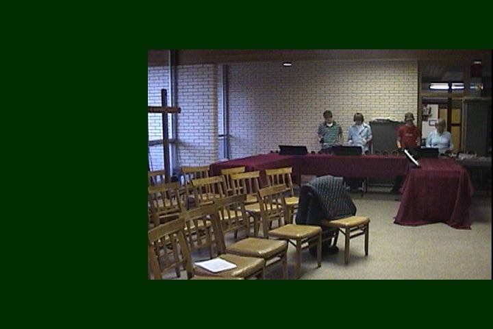

Well, not knowing anything about your source or the display device I'll have to make some assumptions.
Starting from an NTSC 4:3 Source 720x480:
Go into Video Filters and select Resize.
Maintain the Aspect Ratio and set the relative size to 70%
Use whatever filter mode gives you the best results and set Interlaced according to your source.
Under framing options select Letterbox/crop to size and set the new size to 936x480 then click OK.
Then add the Null Transform filter and Crop 216 off the right side. This should leave you with a finished frame of 720x480. The actual video is smaller (504x336), but the aspect ratio is maintained while blanking out the left 30%.
