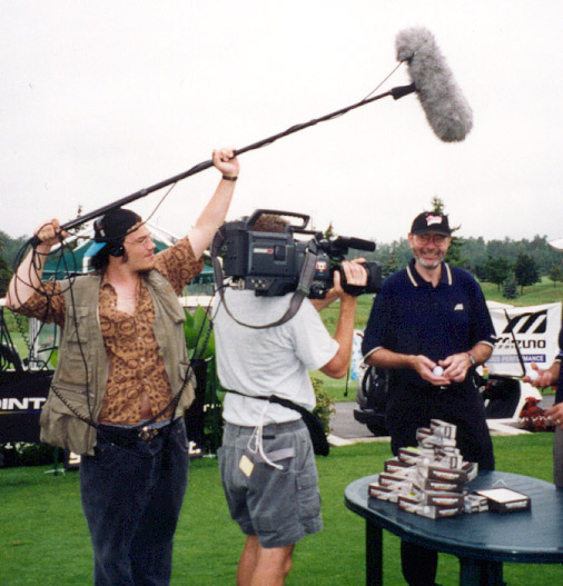

I like Soopafresh's mic suggestions but if you need to record audio live in the field, you will need a boom mic and someone to hold it just above the shot. Don't fight it, camcorder mounted mics won't get pro results.The cam mic track is good for environmental sound but not voice.
http://www.trewaudio.com/sennheiser_shotgun_mic_kit.htm
http://www.samysproaudio.com/kits_boom.phpRecommends: Kiva.org - Loans that change lives.
http://www.kiva.org/about -
And note the furry "Zeppelin" cover on the boom mic above. That thing is absolutely necessary to reduce wind and low frequency noise.
