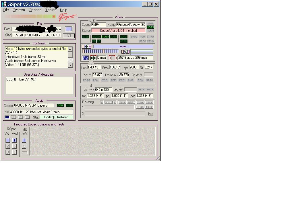

OK, here is the GSpot Screenshot. Apparently, if I'm reading GSpot correctly, a codec named 'FMP4' is required but not installed. Is this the problem?

This happens with decoders that are written incorrectly. They should tell Video for Windows whether the image is the traditional Windows type or the rest-of-the-world type (basically one has the 0,0 co-ordinate in the bottom-left corner and the other in the top-left corner). Get it wrong at the picture appears flipped. This only happens with RGB data coming out of the decoder.
