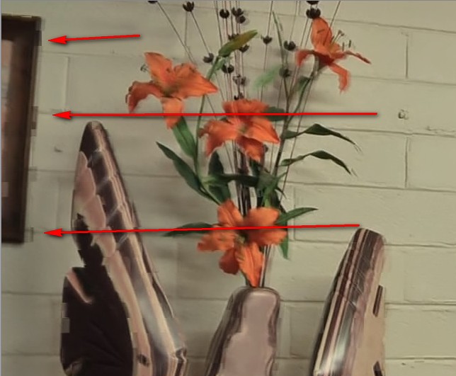

Hi Guys!
I recently purchased a Canon VIXIA HF-100. Right out of the box I have it set to 24p, Cinemode.
Initial tests show some artifacts on a few frames. Blocky and very similar to what I might would see on a MiniDV/Tape camera like my Canon GL2.
However, with this being a flash recorder, I have no idea why it would do this, unless it's either: A) Simply part of the compression or B) An issue with the Flash card (which in this case is a Transcend 8GB SDHC Class 6)
I tried slow camera pans, fast pans, etc. to see if it was a case of the compression scheme not handling certian types of motion. BUT I remember seeing several samples on Vimeo and elsewhere which let me know I shouldn't be seeing as many artifacts as I am.
Granted, it doesn't happen all the time, but the very first sample shot exhibited this and that was disappointing. I did some later tests , and even some using a homebrew 35mm adapter and didn't really see any problems there.
I did verify that it wasn't a playback issue by converting the MTS files to uncompressed/Lagarith AVI and scrubbing frame by frame in After Effects, where the artifacts show up there as well.
By the way... THANKS, Soopafresh! The AVISynth/VirtualDub batch process works well!
I appreciate any help you guys can offer.

Hi FrankLad, no problemo.
Do the artifacts look like this ?
vimeo_00005.mp4
Hey - that does look like what I'm getting!
