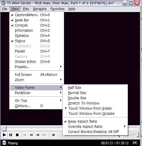

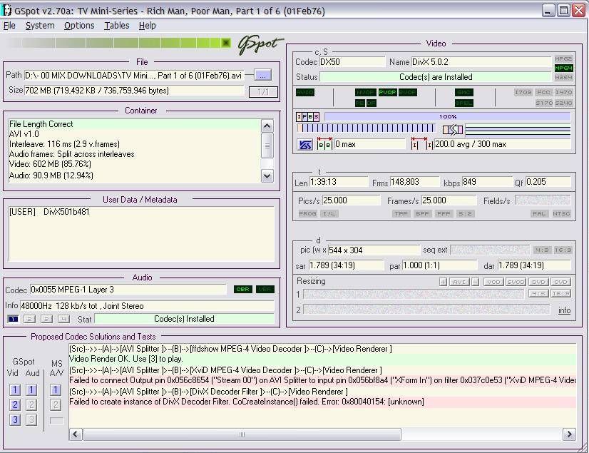

I used G-Spot to see the info about the file. The first screenshot is the original findings of G-Spot. The second screenshot shows the info when I pressed "2" on the bottom of the window. The third screenshot is WMP, it has Keep Aspect Ratio as the default. I can change it to 5:4 when I watch the video but I'd rather change it permanently.
The gspot output shows what you already know - that the display aspect ratio is set to 16:9 (1.78). Obviously you have done something wrong wth mpeg4modifier if you cannot get it to change the settings in your video.

Since it's 25 fps TV, almost certainly it should be PAL 4:3.Originally Posted by HartsVideo
Yes, I saved it as a new video, by adding "5 to 4" at the end of the file name.
I set it to PAL 4:3 and it did the trick, great aspect ratio. Does 25 fps TV always mean that it should be PAL 4:3? Where did you see "TV"? -

So the frame rate of your video, 25 fps, implies it was from a PAL source. Unfortunately, give its odd frame size, 544x304, there is no way of saying exactly how it was treated and how it should be displayed. You'll have to eyeball it. -
