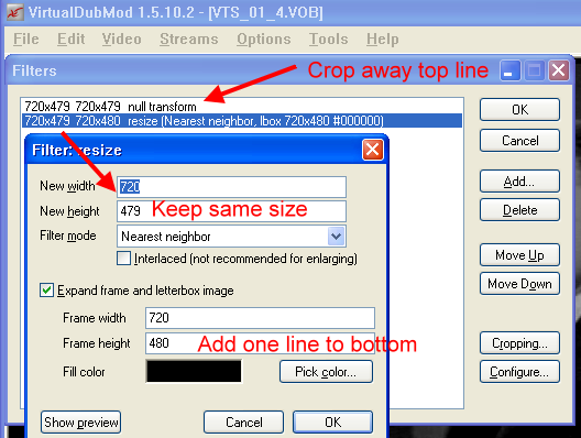

The jaggies are probably doe to a field order issue - there are some good filters for VirtualDub that address this issue. Have a look at the Donald Graft Reverse Field Dominance filter.

You don't need any special filter to reverse field order in VirtualDub or VirtualDubMod. Simply crop one line from the top of the frame and add one to the bottom.

Yes, but any filtering you do in VirtualDub involves reencoding the entire frame. What I suggested is the same thing Donald Graft's filter does except he duplicates the last line rather than filling with black.Originally Posted by rhegedus
