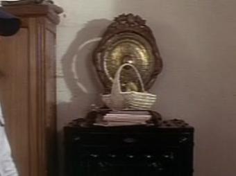

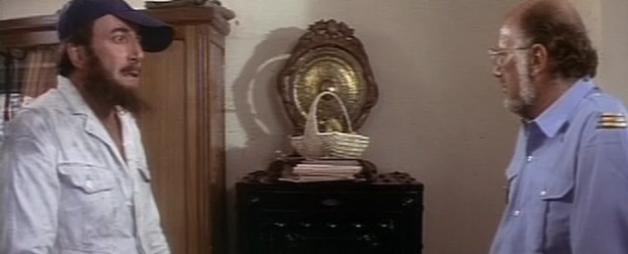

    Virtualdub or AVIDemux, or avisynth. You will have to crop off both ends of the image to get the image to fill the screen (will make it small), or simply stretch it (will look ugly).
    What is theresolution of the video ?
    Read my blog here.
    Dec 2008
    thanks a lot for all the help, i really appreciate it. the resolution is 628x254, i think. sorry to take up all your time on something stupid like this. ill be sure try it out as soon as i can.
  14. Always Watching guns1inger's Avatar
    Apr 2004
    Miskatonic U
    You would have to crop 144 pixels off the left, and 144 off the right. This leaves you with a postage stamp sized video of 340 x 254, but it will be full screen (pan and scan butchered). From there you can scale it however you need to.
    (Actually, to be more accurate, you need to crop 144 off one side, and 146 off the other)
    Read my blog here.
  15. You'll be hacking something like this:
    into this:
