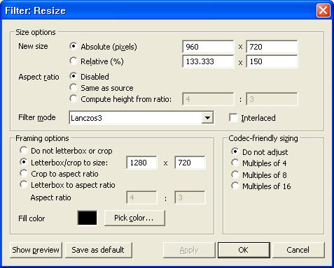

    I want to take a 4:3 DV clip and convert it to pillarboxed 16:9 with the ultimate goal of making faux HD for upload to Youtube.
    I'm using Virtualdub, I've got the Mainconcept DV codec. I find if I resize it to 1080 x 720 and then do letterbox/crop to size 1280 x 720, it achieves the desired effect in the preview screen, but it won't let me save it as DV, even though I have 16:9 checked in the configuration box for the Mainconcept codec. It will however let me save it as Huffyuv.
    What do I need to do to save it as 16:9 DV?
    Thanks for all input.

    DV is ONLY 720x480 or 720x576. If you want it as 16:9 DV you should save it as 720x480 with 16:9 aspect ratio.
  3. Member Alex_ander's Avatar
    Join Date: Oct 2006
    Location: Russian Federation
    Resize from 720x480 to 544x480, add borders to complement it back to 720x480, then save as 16:9 DV.
    In VDub's resize filter pillarboxing can be done by typing 544x480 for 'new width / new height' and leaving default 720x480 for 'frame width / frame height', with checked box 'expand frame and letterbox image".

  8. Lanczos4Resize(960,720)
    AddBorders(160,0,160,0)

  10. It's an AviSynth script. I don't use VDub for filtering as I prefer both speed and quality. VDub has the ability to add pillarbars, I think. Look around.

    Okay, thanks. I did get it to work as far as showing up in Vdub, but won't save as DV. Ended up saving as Huffyuv and then converting to mp4 w/AAC audio in Super.
    It does come up with the HD option on YouTube, and the sound is in stereo however the motion is very jerky.
  12. You can only save 720x480 29.97 fps, or 720x576 25 fps as DV. DV encoders will refuse to save any other frame size.
    You can add pillarbox bars in VirtualDub with the resize filter. Use the "Letterbox/Crop to size" option in the lower section.

  14. If you must use Super afterwards (rather than uploading VirtualDub's output to Youtube) compress with HuffYUV, Lagarith, or uncompressed to retain as much quality as possible. The intermediate file will be large. It may also be possible to frameserve (pass uncompressed frames directly from VirtualDub to another application without saving to an intermediate file) to Super.
    Also, since you are no longer using a DV encoder you may find it better to use a 16:9 frame size with square pixels. For example, resize your 4:3 720x480 source to 960x720, add pillarbox bars to bring the frame width up to 1280 (160 each side), then encode as Xvid/MP3 AVI. Upload that to Youtube.
