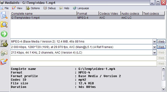

    jfharper - 2nd update. the higher bitrate mp4 is a success. it gets the watch in HD link - http://www.youtube.com/watch?v=hk_j66xY8mY&fmt=22
    it look like the 720p has to have a bitrate closer to 5mbps than the 2.5mbps i used on the first one. the actual settings i used were 1280x720p 29.97fps best/main profile/ 2 pass vbr 5mbps ave, 10mbps peak, 256kbps aac 44.1htz.
    the reduction in file size was from the 175mb source DVavi to the 30mb mp4. the video quality of the HD yt vid is not bad at all. much much better than the usual crappy flv youtube video.
    here are the mediainfo specs of the downloaded yt vid.

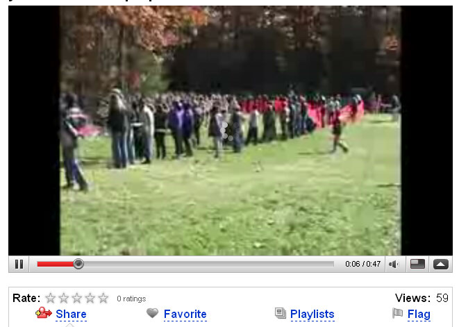

    well yt accepts the header patched mpeg-2 and makes a HQ vid but not HD. here it is.
    http://www.youtube.com/watch?v=JL0RfphGKiI
    plays a small sized vid inside the large HQ player.
  23. The Old One SatStorm's Avatar
    Hellas (Greece), E.U.
    Ha ha ha ha, that's funny!
    Anyway that means something: We need to find the correct way to patch stuff and upload them.
    Thank you very much for the test!

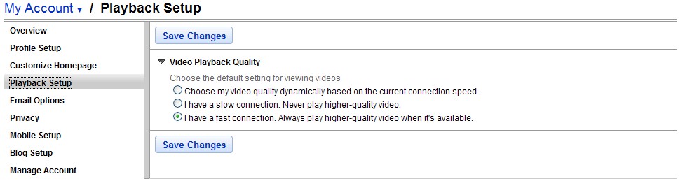

  29. aBigMeanie aedipuss's Avatar
    Oct 2005
    666th portal
    could be autodetection on yt's part. if you go into your account settings you can change your internet connection type to always highspeed if you wish.
  30. OK, I made that change on the Flash 8 dial up 28.8 computer and visited my own video and the Watch in Normal Quality link appeared, indicating it was displaying HQ and the connection speed was fast enough (not really tho) and Flash 8 is OK for HQ.
    Same computer, visited your link with fmt=22 and no Watch in HD link, or normal, or HQ links.
    Tried different system with Flash 9 and setting switch to "fast connection" using dial up 28.8 speed, and visited your link, no Watch in HD, normal, or HQ link was displayed.
    I think the Flash version affects it too. I think Flash 10 or 11 is required for HD.
    What Flash version are you using?
