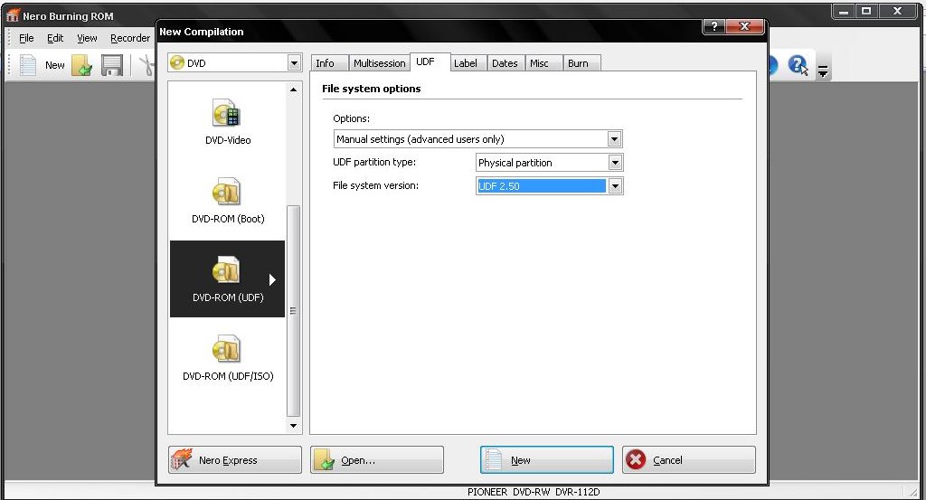

udf 2.5 if that is what you meant. -

Ok, use TsMuxer to create a "BluRay" disk file structure from your .mkv, then copy the required folders from it into your "AVCHD" (leer) disk file structure overwriting when it asks. Now burn the folder structure to DVD-r using (well i use Nero Burning Rom) whick ever burning software you like. It will have to be burt as a UDF dvd rom disk with a setting of 2.50!
