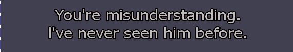

OK, say I start with a common Tahoma font with nice round "O's" and normal looking letters and want to create subs for both 16:9 and 4:3 TV sets. Here's a pic for a PAL DVD meant to play on a 16:9 TV set:
And here's one for a PAL 4:3 TV set:
These are pics of how the BMPs themselves would look (ignoring the colors) and they get resized for the TV on which they'll be playing, so they'll look normal at playback time. The 16:9 one has very narrow letters which get widened at playback time on a 16:9 TV set. The 4:3 one has only slightly narrowed letters and also gets resized correctly at playback time, this time on a 4:3 TV set.
I don't mean to denigrate your efforts, and I'm sure some will find the fonts useful, but your workflow is inefficient and produces results of lower quality than if you did it differently. -
