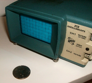

There are two reasons that early picture tubes were not flat and square. The other one is that they are blown glass, and rounded shapes are much easier to make.
The way to make a flat square CRT without dynamic beam focus is to make the neck very deep like these oscilloscpe tubes. Just imagine a 27" TV that is ten feet deep.

Already done. The two blue neck tubes on the right above are from Tektronix oscilloscopes.Originally Posted by SingSingRecommends: Kiva.org - Loans that change lives.
