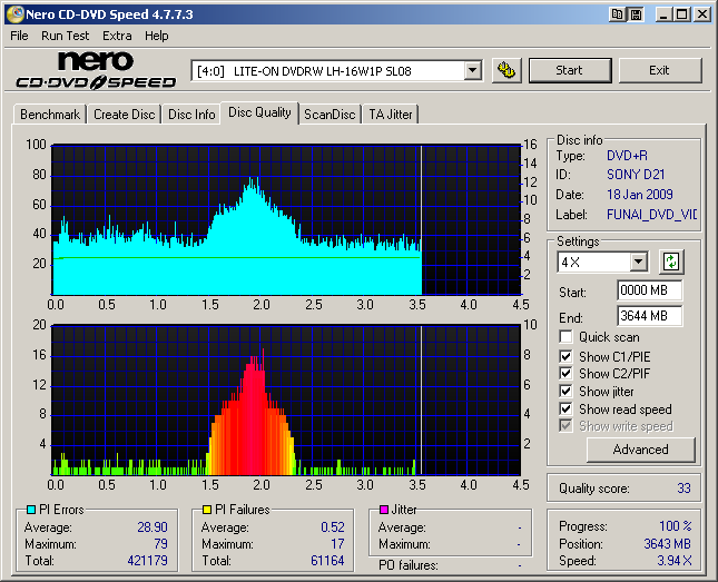

Here's a disk scan showing the media ID.
[/img]

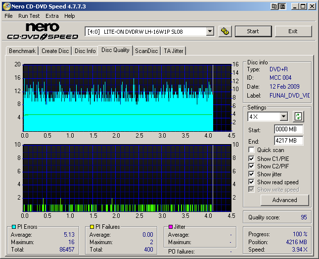

I have burned a few Sony +R 16X on the Philips. They played, but ripped to hardrive rather slow.....4X. Comparative disk scanning showed the Sony media to have a PIF rate over 10 times higher than Verbatim. Here's a scan of one Sony disk which had visible flaws after burning....it's a coaster.
