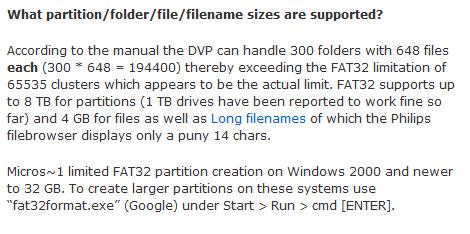

    It should work, but the 5990 does have a file system limit, I think about 648 files it can see. I used SwissKnife to convert the drives to FAT32, but the largest I converted was 500GB and it had about 480 Xvid/Divx files on it.

    Oh... so is it pointless to have a TB hard drive on the 5990? Could I get more files to be seen? Like putting them in different folders or different partitions? Hmmm, cause if not i would get some smaller drives

    Ah, yes, ive came across that site, and have read it before, when i was looking up the customized firmware by vb6rocod. I just didnt remember it too well and forgot if i did indeed read that, n where it was from. Well, I'm going to get another TB drive. I guess im going to get a drive locally which is prob a WD MyBook to test around first, if that dont work w/e it will become a computer backup drive.

    It does work. I have two 1TB drives formatted to FAT32 that I used with the 5990. To get around the file limitation, you have to organize your content. What I did was create folders from A-Z and place all the movies in the appropiate folders according to the name.
    It will be VERY hard to search through everything if you have all your content in the root of the drive.

    I have a 750GB Seagate and Maxtor 640GB(Daughters) and both work with 5990. I put my extracted dvd's in thier named folders with the video_ts folder as a sub folder. You don't need the audio_ts. That would mean with the 300 folder limitation, 2 folders per Movie, a max. of about 630GB. (approx. 4.2 GB per folder x 150 folders).I have some xvid files also. I haven't tried this yet but I guess if I name xvids and put up to 300 in folders I could get much more out of the space.
