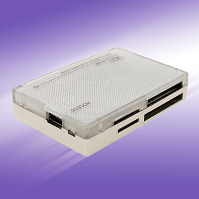

  5. Member Number Six's Avatar
    Mar 2008
    The internal card reader in my computer can't read Memory Stick Pro, but it can read standard Memory Stick. I do not have any SDHC, but I am assuming that my reader can't read that as well because it is almost 5 years old. I bought an external USB card reader that reads Memory Stick Pro, SDHC, and any other new technology format that came out recently - I bought it on eBay for $5, but you can get them in stores for under $20. This will probably be your best and easiest solution for your computer, but it will not help you get the camera to recognize the SDHC
    What model camera do you have?

  12. Member Number Six's Avatar
    Mar 2008
    Again - your best and easiest solution would be to get an external USB all-in-one card reader. It can be used with any computer that has a USB port.
