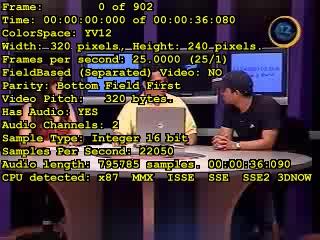

    2) Add Info() to your script, as a starting point
    DirectShowSource("file.flv")
    Info()
    In this example, I just used DirectShowSource("file.flv"), and it reported what avisynth thinks is the internal frame rate. In this example it was 25fps. I would use that as a starting point, test it out in MPC for synchronicity, and adjust it if necessary (FYI, this test clip was also h.263/nellymoser/.flv with VFR)

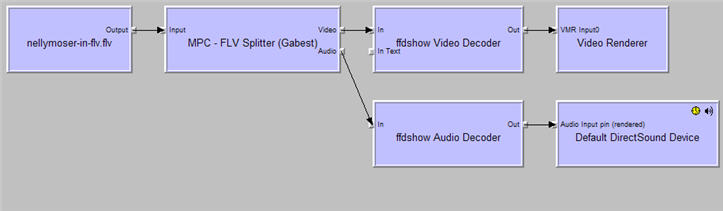

    Note you may need a proper FLV splitter (I mean audio/video splitter, not as in a file splitter that cuts into segments) registered in your directshow system in order to "see" nellymoser audio, and you need a proper nellymoser decoder (a free one would be ffdshow). A good utility to do this is graph studio (render your file in graphstudio, and see if audio & video can be "seen")

    When you open the .flv in graph studio, you should get something like this, otherwise you are missing some components or haven't enabled the proper decoder:

    This is what my thing looked like on Graph studio:
    edit: Directshow said "I cannot determine the frame rate of the video, you must use the "fps" parameter." What does that mean?
