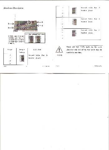

So I have a PNY sata raid 2 ch card (model p-dsa150-pci-rf).
I have a bluray bdrom connected to the pci card internally. I have a western digital 320gb external drive that has usb, firewire, and esata connections. I finally picked up an esata cable the other day but I'm not having any luck getting it to work with the external drive.
Here is a shot of the PNY manual regarding jumper settings for internal and external port settings:
Now I understand it says you can only have two active sata connections at once. What it does not say is whether or not they can be internal and external at the same time.
Is this possible with this card?

	no - from the manual -
 <<Connect a maximum of 2 SATA hard drives to any of the 4 connectors (Either 2 internal or 2 external) via jumpers to your desktop computer>>

 So that 2 internal or 2 external should be taken literally as "EITHER OR" not both then?

	I would try one of the internal MB SATA connections to verify that your cable and external drive are working. It looks like that card can either use the two external sockets or the two internal sockets, but probably not a combination. It's also a SATA 150 card, although there's not much difference in speed to a SATA 300 card.

	yes either 2 in or 2 out. not a mix.
